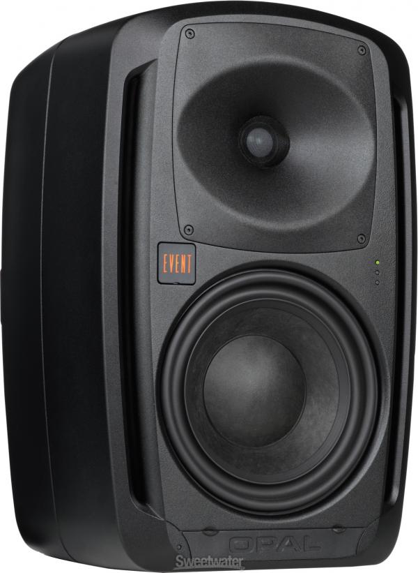

Poslušal sem Adam, Dynaudio in Event v trgovini Audio Pro v Ljubljani (zraven BTC). Za Event Opal sem prvič slišal, sem bil pa nad njegovim zvokom navdušen. Definitivno boljši od ostalih aktivcev v istem cenovnem rangu (2700€/par). Ne moreš verjet, da nima srednjetonca! Woofer in beryllium tweeter opravita vso delo.
Evo nekaj karakteristik, ki se poznajo tudi v praksi:
Frequency Response: 35Hz-22kHz
Crossover Frequency: 1600Hz
Crossover Type: Acoustic 8th Order (48dB/Oct)
3rd Harmonic Distortion: @ 90dB SPL, 1m:
- 500 - 7kHz - 0.08%
- 200 - 20kHz - 0.2%
- <200Hz - 1.5%
Acoustic Output: SPL @ 1m
- Long Term (80Hz - 20kHz): 111dB

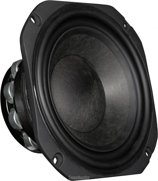

EX8 Low Frequency Transducer Specifications
Piston Diameter: 180mm (7.1 inches)
Former Material: High Strength Polyamide - Glass Fiber
Magnet Type: Neodymium
Magnetic Gap Design: XBL - Split Gap
Impedance Nominal in Cabinet: 5 Ohms
Power Handling:
- Continuous Pink Noise: 240 watts
- Program Power: 360 watts
- Peak Power: 720 watts
ULD1 High Frequency Transducer Specifications
Dome Diameter: 25.4mm (1 inch)
Impedance DCr: 6 Ohms
Dome Type: Beryllium Copper
Power Handling:
- Continuous Pink Noise 25 watts (above 1.6kHz)
- Program Power 50 watts (above 1.6kHz)
- Peak Power 100 watts (above 1.6kHz)
Low Frequency Amplifier Specifications
Frequency Response: 20Hz - 20kHz (+/-0.1dB)
Operating Band Pass: 20Hz - 1,600Hz
Total Harmonic Distortion: 0.009% @ 300 watts into 5 ohm load
Voltage Gain: 24dB
Long Term Power @ 5 Ohms: 270 watts
Continuous Power @ 5 Ohms: 387 watts
High frequency Amplifier Specifications
Operating Band Pass: 1,600Hz - 20,000Hz
Total Harmonic Distortion: 0.003% @ 90 watts into 5 ohm load
Voltage Gain: 15dB
Long Term Power @ 5 Ohms: 50 watts
Continuous Power @ 5 Ohms: 112 watts

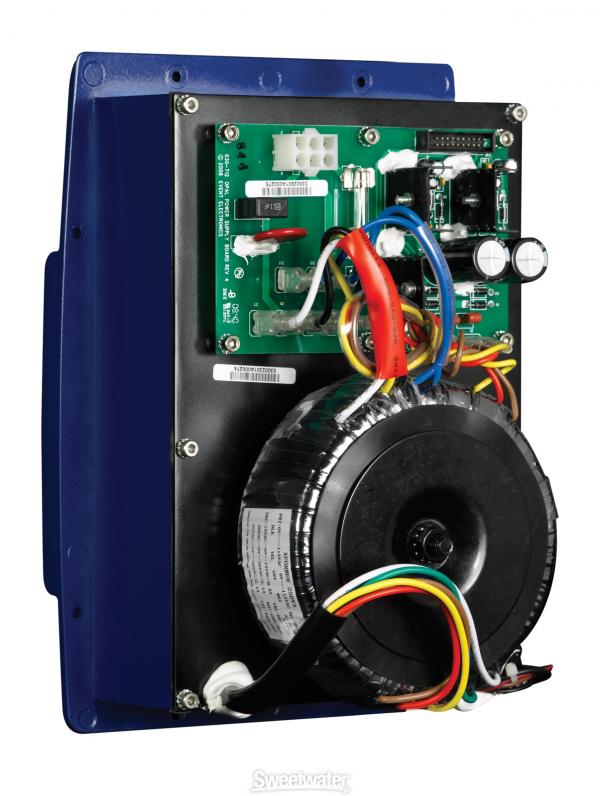

Izgled:
Napajanje in hladilnik:
