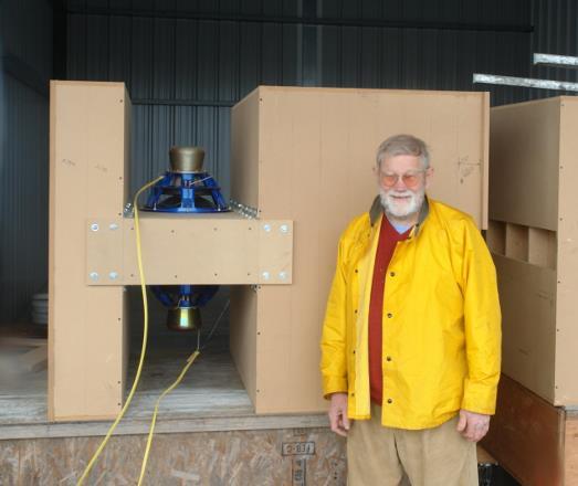

Prijatelj Randy je zgradil nekaj, kar je dejansko ultimativni subwoofer..Hočem enega
Manjšega, seveda..!
This is an experimental Labyrinth Transmission Line with dual 15" drivers of very long excursion of 1.5 inches +/_. We were able to actually do 2Hz. 4Hz came on with significant power and 8Hz shook the very large hanger. This is the mother of all sub bass systems. It is also 98dB efficient so with 500 watts at our disposal we could do real damage. The Guinness Book of World Records is 4Hz by another TL. We handily exceeded it. It's a real Infra Bass.
I plan on using these (down in Reno) to sonically test some buildings we will be constructing. The Code on Sound Propagation cuts off at 125Hz which is near meaningless.
For completeness. They are flat to 12 Hz and with modest EQ flat to 8 Hz but still quite strong at 4 Hz and still pressurizing at 3 Hz. Tested by Thilo Stompler to be 93dB efficient at 12 Hz. His 15 inch woofers with a 1 1/2 inch LINEAR travel.

s katerimi driverjije je to narejeno....motorji spominjajo na Aura Sound z neodimium magneti, ampak mislim, da so imeli samo 18" v svojem arsenalu.

tukaj je nekaj malega o Auri, ampak zgleda da ni enak driver kot zgoraj na sliki...druga kosara, ampak enak magnet.
http://www.goodsoundclub.com/Forums/ShowPost.aspx?PageIndex=1&postID=4177#4177
Lahko gre tudi za kaksen custom sestavljen driver...aura motor, kosara kot pri GZ plutonium seriji (jo uporablja se kup drugih), soft parts?
