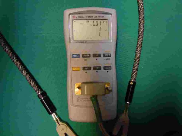

OMG i had to know that this argument will generate a lot of embarrassing situations.... anyways...
The R is of course from a side to another of a cable, a liquid, a gas, a resistor etc... otherways will be an insulation test and in order to do that you need an high tension generator.
(By the way... i done this and all the cable where insulated more than 1000V... considering that they have to carry a smal V signal is a nothworthy result... but if your friends are interested we can test it till 25.000V)
The C is of course the interaction between 2 elements.
The lenght of the cables was the same cables, i exactly don't remember but i think was little more than one meter (1-1.1m)?
The LRC parameters where taken with a LRC bridge that have the double wire (not all have this) in order to annul his effect and iteration on the measures.
See the picture attached to see how the test where done.
upornost
L
C
 _________________ Lp
Bernard
Live and let live. |

Berni, kot sem napisal zgoraj, žica je bila (verjetno) merjena v izolaciji, brez upoštevanja povratnega vodnika. Ko sem videl slike, sem 99% v to
Ker je na sliki RCA konektor, je sredinski pin dovod, ohišje pa odvod. Dokler tokokrog ni sklenjen, tok ne teče. Osnovnošolska fizika.
Ker teče tok po obeh žicah, ampak v nasprotni smeri, se magnetno in električno polje izničuje, posledično je induktivnost bistveno manjša kot pri osamljeni žici v prostoru.
Če meriš induktivnost ene žice, ne moreš uporabiti te vrednosti pri dveh žicah, po katerih teče tok v nasprotni smeri.
http://www.eeweb.com/toolbox/wire-inductance/
Na zgornjem linku imaš kalkulator induktivnosti posamezne žice. Premer 1 mm in dolžina 1 meter nam da ~1,5 uH. V tabeli na prejšnji strani je navedeno 1.3uH. Za hec sem šel pomerit 150 cm dolg interkonekt s tanko sredinsko žico in dobil 2.5 uH. Merjena samo sredinska žica
Na levi, pod enojno žico je link na Parallel wires. Premer 1 mm, razdalja med žicama 2 mm, dolžina 100 cm in dobimo 527 nH induktivnosti.
Tista formula* zgoraj:
(Induktivnost v nH/meter * kapacitivnost v pF/meter) / 11130 = X
je namenjena ravno hitremu preverjanju dobljenih podatkov, če so sploh v sozvočju z fiziko našega planeta. Ker pri objavljeni tabeli niso, jim ne verjamem.
*Ker gre pri audiu za frekvenčni obseg 20-20 kHz, to pomeni valovne dolžine nekaj kilometrov in ker je 1 meter kabla pri teh valovnih dolžinah zanemarljiv in ne predstavlja ne 1/2, ne 1/4, niti 1/8 valovne dolžine, je vse skupaj poenostavljeno in izključno namenjeno hitremu preverjanju podatkov, ki jih navajajo audiofili za svoje kable.
Rezultat manj kot 1 pomeni, da smo presegli hitrost svetlobe v vakuumu, torej je Nobelova nagrada še najmanj, kar nam sledi.
Rezultat več kot 10 pomeni, da smo tako upočasnili elektrone v kablu, da znova zaslužimo Nobelovo nagrado za fiziko.
Vstavimo induktivnost, ki sem jo dobil jaz s pomočjo gornjega linka, kapacitivnost pa iz tabele za SE 2, recimo za 1 kHz:
527 nH * 83.5 pF = 44004,5
44004,5 / 11130 = 3,953
Torej faktor 3,953, kar je popolnoma realno in pomeni, da gre za kabel z solidno, čvrsto geometrijo, vodniki niso preveč narazen.
Zdaj pa podatki za REF SE CABLE, znova za 1 kHz, induktivnost je enaka kot prej:
527 nH * 265,1 pF = 139707,7
139707,7 / 11130 = 12,552
Faktor 12,552 kaže, da še vedno nekaj ne štima, ker je večji od 10.
Če uporabim originalne podatke, dobim faktor več kot 30
Zdaj pa sledi sklepanje in glasno razmišljanje:
Ker se je glede na SE 1 in SE 2 kapacitivnost zelo povečala, sklepam, da je možakar povezal več žic skupaj na maso. Ali pa več žic skupaj na sredinski vodnik. Lahko tudi, da gre za mikrofonski kabel ali kaj podobnega, kjer sta 2 vodnika v kovinskem opletu, kot pri koaksialcu. Če je povezal oplet in en vodnik, potem gre kapacitivnost gor, induktivnost pa dol. Vseeno mi je čudno, da je kapacitivnost tako velika, glede na 1 meter dolžine. Ne vem, ni me bilo zraven.
Kakorkoli, če ima možakar signalni generator in osciloskop, bo hitro prišel do točne induktivnosti
Če koga zanima: http://www.microwaves101.com/encyclopedia/z0.cfm _________________ My DMM will go only to 10, maybe your DMM can go to 11? |

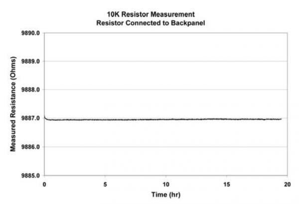

Cenjeni,
spet bi v audiu odkrivali toplo vodo. Problem štromarjev je, da nas na faksu naučijo nekaj teorije in potem smatramo, da je ves svet sestavljen iz idealnih elementov. Šele ko te začno tepsti efekti drugega ali tretjega reda ugotoviš, da se vsega ne da razložiti z idealnimi upori, kondenzatorji, tuljavami in po novem memristorji.
Zakaj mislite, da se proizvajajo kabli z garantirano nizkim triboelektričnim efektom http://www.systemswire.com/low-noise-triboelectric-cable.html, zakaj je predpisana testna metoda za meritev http://www.affinitymed.com/news/2007/july.aspx in zakaj lahko kabel še nekaj ur po odvitju s koluta proizvaja dovolj šuma, da moti meritev upornosti 10kOhm upora? http://assets.newport.com/webDocuments-EN/images/TN5900-1_Triboelectric_Effects_IX.pdf
[/img]
Še naprej uspešno debato o karakteristični impedanci vam želim. |
AndrejS
Objavljeno: Tor Jun 17, 2014 01:28 Naslov sporočila: |
Zivjo,
Meritev kaze spremembe upornosti v promilih. Meni se tale uporcek zdi znotraj specifikacij proizvajalca. Variacija upornosti je zelo majhna in jo lahko pripises temepraturi. Ze 1C razlike, ga bo vrglo cez to kar so izmerili. Odnostno, komora v kateri meris mora imeti stabilizirano temperatureo na 0.1C, da se to lahko gres. Ko to vgradis v sobo, prostor, so odkloni enormni.
Dealmo pa klasicno Slovensko statistiko, ko za stevilo vzorcev vzamemo 1 in privzamemo rezultat lezi znotraj 5 sigma. Torej vse mozne razlage.
Jasno, da ni idealnih elementov, lahko pa njiove karakteristke izkoristis, ce jih poznas.
Sploh pa, starejsi si, bolj se zavedas in razumes kako stvari delujejo, vecji low pass filter imas v usesu.
Andrej |

Objavljeno: Sre Jun 18, 2014 00:05 Naslov sporočila: |
| AndrejS je napisal/a: | | Meritev kaze spremembe upornosti v promilih. |
Kok dB je že to?
| AndrejS je napisal/a: | | Variacija upornosti je zelo majhna in jo lahko pripises temepraturi. |
Gotovo. Če je človk prepričan, da efekta ni ga pač ni.
AndrejS
Objavljeno: Sre Jun 18, 2014 00:21 Naslov sporočila: |
Zivjo]
Kok dB je že to?
-73.86dB. In?
Devijacija zaradi 1C je pa 30dB vecja.
Preprican sem, da ima marginalen vlpiv, saj so variacije zaradi temperature vecje. Pri cemer generiranje suma sploh se nismo upostevali.
Velja pa klasicno pravilo, da se mora sistem malo ogret. Super ideja!
Ambasador je prav povedal, ce premikas decimalke res rata drama na vsakem vogalu. Smiselno je razmislit, kje imajo naprave/pasiva najvecje napake in tam kaj postorit.
Vec ali manj gledate praskico na podvozju pri cemer ste spregledali, da je avto v celoti razbit. Za podati idejo o skali.
Andrej |
